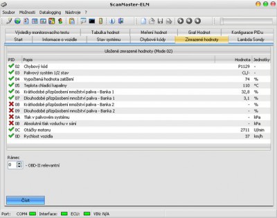

Chybový kod P1129
Nevie niekto kde môže byť chyba?Auto ide normálne.Presny vypis chyby je:
P1129 - Downstream Oxygen Sensors Swapped from Bank to Bank (HO2S-12-22)
The HEGO monitor checks and determines if the HO2S signal response for a fuel shift corresponds to the correct engine bank. The test fails when a response from the HO2S(s) being tested is not indicated. Crossed HO2S harness connectors (downstream).
Crossed HO2S wiring at the harness connectors (downstream).
Crossed HO2S wiring at the 104-pin harness connectors (downstream).
