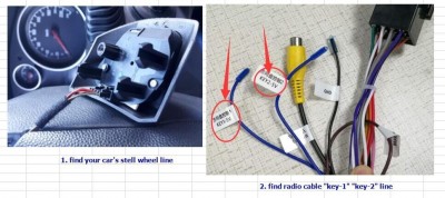

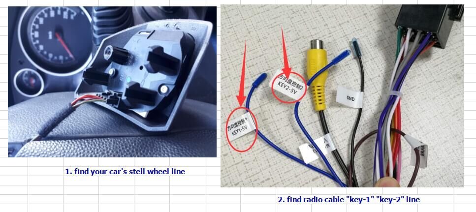

Re: Android OEM Ford rádio
tak reakce od prodejce >> a teď babo raď <<
hi,dear ,about steer wheel function
you only need to connect the key line of our radio to your car's steel wheel line. How to find them,: see below:
(1) our radio key line is two brown line, it writes " key line"
( 2) for your car, usually the line is called CTR or remote or STW or steer wheel line, you can find your car’s power port diagram to find the line, then connect to our radio cables’ “ key line”. all will be OK.
- Příspěvky: 25170
je to srac
