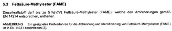

Příspěvek od pelen » 02.08.2007 21:17
Tato odpoved je v souladu s normou EN 590.
Biodiesel is a renewable diesel fuel consisting of fatty-acid alkyl esters, known in Europe as FAME (fatty-acid methyl ester)
http://www.paclp.com/product/PetroSpec/ ... diesel.htm
Proto se nemusime obavat, primes bionafty az do 5% je vyzkousena. Norma plati pro celou Evropskou Unii.
