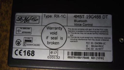

a jaký BT modul by tam šel?
tento by tam šel?
tento by tam šel?
